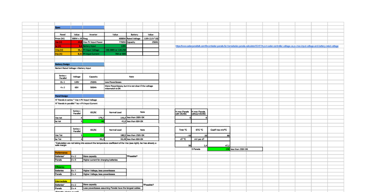

      Can you take a look at my excel sheet to see if what i'm calculating is correct?
      From your answer i can assume i can't double my total battery pack capacity.
      At the same time my observation doesn't hold anymore in this new case since a 5x4 and 4x5 lead to a maximum voltage of 181V and 145V respectively which are below the Voltage input range of 120-250V.

        Can you give your opinion regards this excel sheet i've done?
        https://docs.google.com/spreadsheets...=0&single=true
        If what you are saying is true then it seems that i can't go for a doubled capacity since i need to maintain 120V. Moreover if those are the new specs i have no problem regarding my last observation as well.

          I'm glad to see you are considering the temperature effect on Voc. I can not see the content of the formulas in the spreadsheet, and some of the calculations look off on superficial inspection.
          What is the model of your inverter? What panels are you planning on using (first post said 250 W, 2nd post said 300 W)?
            Sorry for the double post.
            Try this link
            The panels are indeed 300W * 20
            The model is an ALLRUN Qingdao model (pretty unknown).
            Can you be more precise regarding the mistakes?
            Thank You,
            Max
              I don't understand your Voc temperature adjustment calculation. Typically, the coefficient would be published as something like -0.32% / deg C, which translates in this case to -0.32% * 43.2 = -0.14 V / deg C. In the extreme case of -10 deg C, relative to the published STC value @ 25 deg C, that is -35 deg C difference. -35 * -0.14 = 4.9 V per panel increase in Voc. 44.8 + 4.9 = 49.7. With 4 panel strings, that is 4 * 49.7 = 199 V, while 5 panel strings would be 248 V. That is the number to compare to the max PV voltage input allowed for the charge controller portion of the system.
              In your battery design section, you have "8 x 1" next to 120 V, and "4 X 2" next to 60 V. Are those voltages intended to indicate the min PV voltage that is required to charge that battery bank?

                It is true that normally the Temp Coeff is -0,32 %/°C but in my datasheet it is reported as - 80 mV / °C hence i'm assuming that for each °C i have -80mV and since the delta temperature is 35°C / 30°C i've just multipied the two.
                I've reasoned like that because it can't be 80%/°C (i doubt it is 0.80% as well) and because the Power Coeff and the Short Current Coeff are reported as you say in %/°C.
                Of course the design that uses OC/SC has already safe margins because it means that all the solar panels should break at the same time (correct?), so even if i would be reaching the Max PV Voltage the effective voltage (under normal condition load) would be lower.
                The second question is related to the answer you gave me, you said that "96 V inverter requires 96 V battery, 48 V inverter requires 48 V battery. No mixing" , were you referring to the fact that i can't mix 96V with 48V batteries or i can't mix (in this case) 120V inverter with 60V batteries (due to the parallel/series design of the battery)? In short, if i have those batteries with 12V * 10 = 120V can i put only 6 of them in series with other 6 batteries in parallel in order to achieve 60V (in a 120V input inverter) and so double the capacity? Is it worth in first place, powerlosses aside?

                        I don't see what is reported incorrectly. The battery bank you would use with this inverter is 96V. The PV strings would be designed to provide a Vmp of at least 150 V, and keep the temp corrected Voc below 300 V.
                        Does that help?
