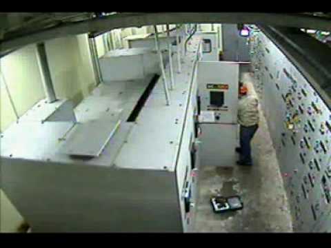

You picture reminds me of someone setting up the meter to read current then attached the leads from line to ground on a 120 Vac circuit. In that case it will go BOOM! and burn th ecrap out of you and quite possibly start a fire. On a 10 amp shunt connected to 120 Vac would induce in theory 24,000 amps, although the transformer could not source that much fault current. Bottom line several thousand watts being dissipated in your hand for a second or two. AKA Arc Flash.
Speaking of Arc Flas here is a cool video. They delivered the body in a small paper sack to the wife.
MSEE, PEComment
