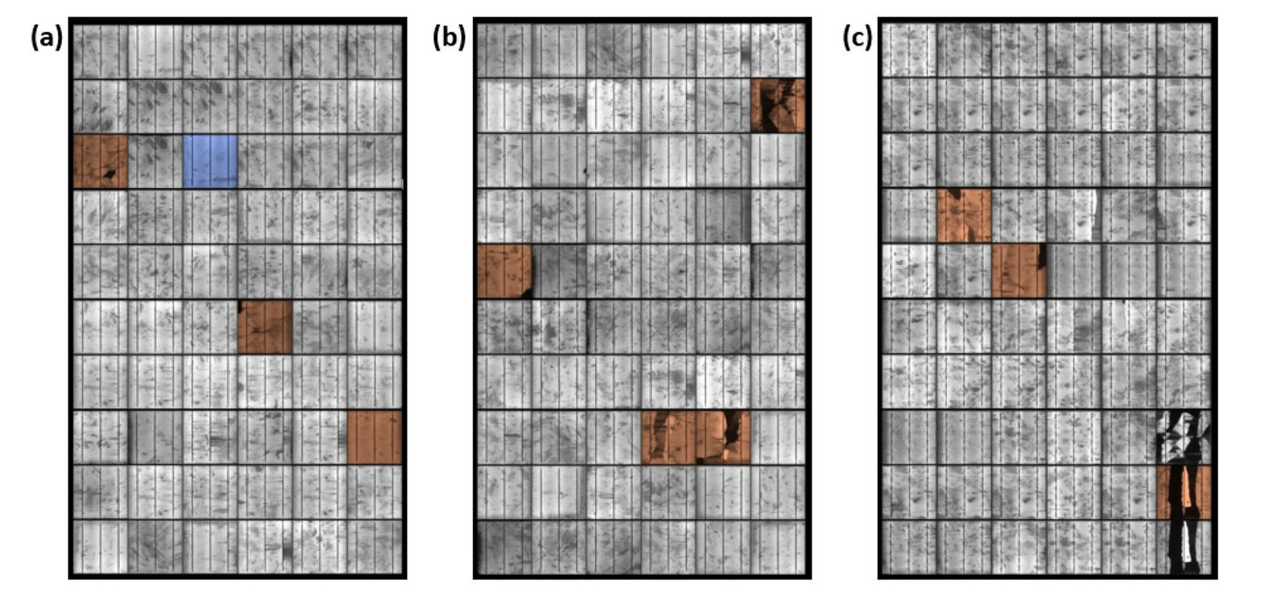

            Any cracked panels I would consider probable failure points
            before long, and keep them apart from the rest of the system.
            Bruce Roe
            I've been surprised with how well (at least initially) panels with cracked glass work. I've compared Voc and Isc with other panels and found no difference. I think the issue will be eventual moisture ingress leading to the failure.
            Recent research shows cracked cells (not just cracked glass) has a minimal impact on panel performance.
            UK researchers have found that crack percentages of up to 11% have a very limited impact on solar cell performance. They also ascertained that hotspots are likely to arise when the crack percentage is in the range of 11 to 34%.

                nerdralph Good to now. In the 2 years those 4 panels have been cracked, I have not noticed any degradation in performance (this is with micro inverters). I do still plan to move those 4 panels to their own string, just as a precaution.
