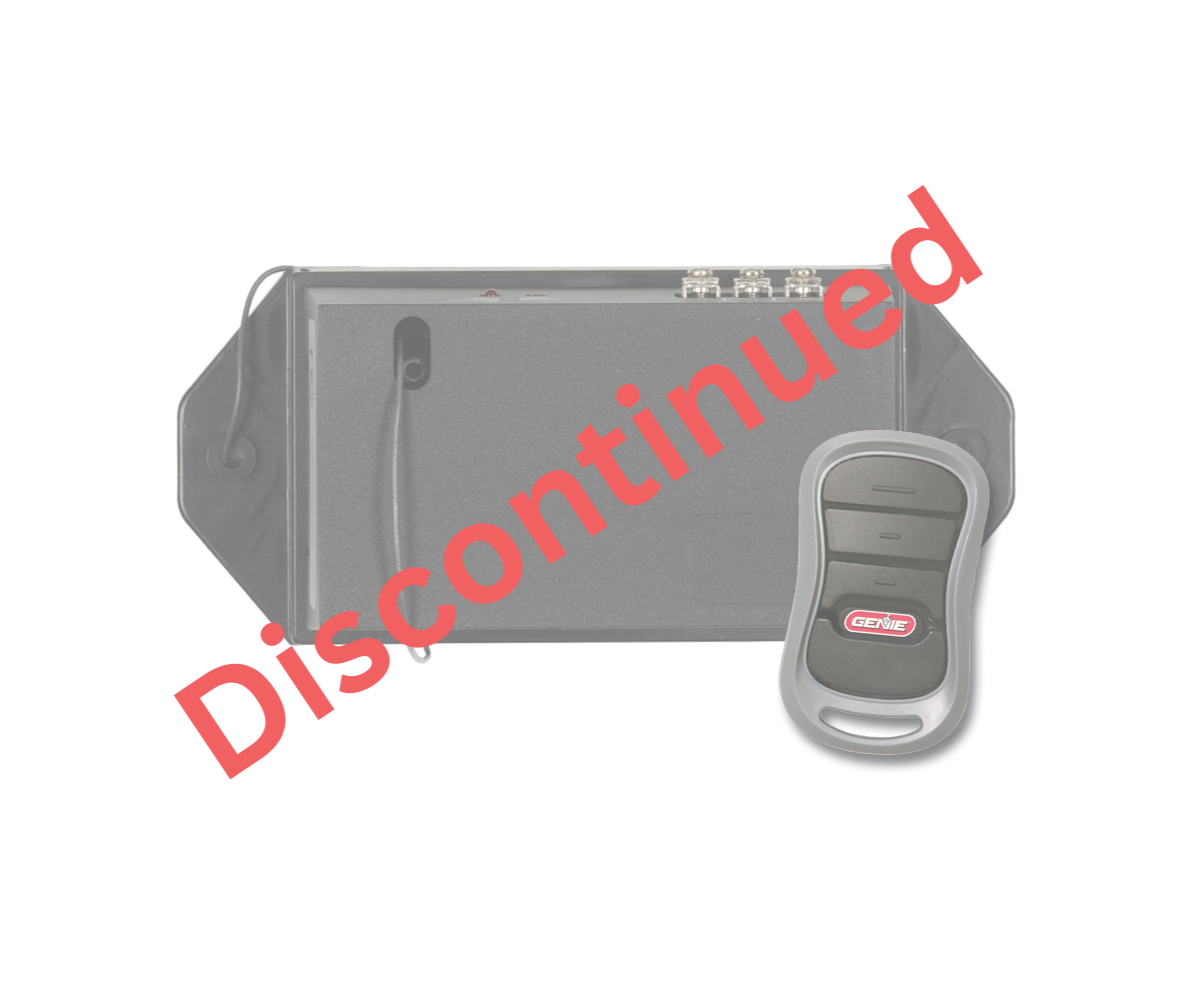

                        One thing that might work is to install a different receiver with a different remote control somewhere else, like near the button you push to open the door from inside the garage. I think Genie makes one, designed as a retrofit for older systems. It would let you re-locate the receiver away from the interference.
                        • sdold
                          • Jun 2014
                          • 1475
                          This one seems like it would work. It basically connects in parallel with the wall button and although they show it being installed on the ceiling near the opener, I don't see why it couldn't go on the wall somewhere away from the solar array.
                          The Universal Dual Frequency Remote Conversion/Upgrade Kit is used to upgrade nearly any model garage door opener to use modern (secure) remotes. Acts as a replacement receiver for older model garage door openers. Universal- works with nearly all model garage door openers that have required safety beams installed.
