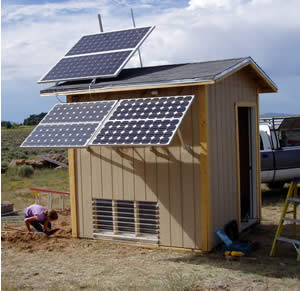

          With all the hassles I am having to go through with mounting my panels, I was thinking about doing the wall mount option. If anyone knows where I can get wall mounts sufficient for 310 watt panels, please post a link. The ones I have found on Amazon and eBay have been 28" wide max. I think my panels are a little wider.
          I am looking to do something exactly like these lower 4 panels on the back of my house if I could find the mounting kits for them. Then I don't have to worry about putting holes in my roof nor worrying about having to spend $290 for each ground mount and get permits to pour concrete structures all over my back yard. These panels would be almost like awnings. Super easy to walk underneath so I could get easy access to do the wiring.

              I framed an eyebrow across the south side of a friends house in Baja. I then used conventional racking (pro Solar) screwed to the framing to mount the panels. I made sure to use plenty of Simpson hardware and screws for strength.
