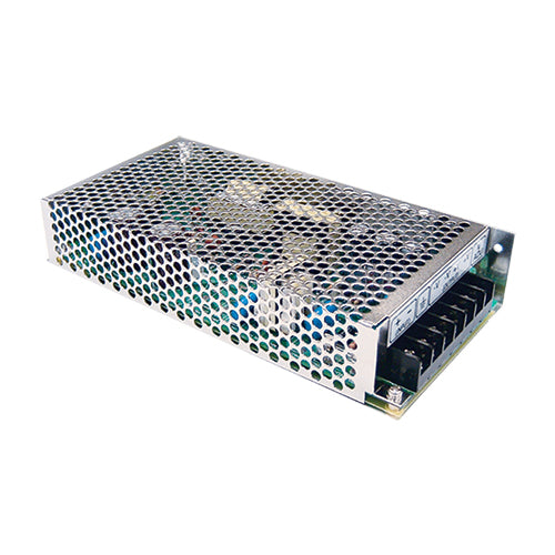

      You could do the lights, two in series connected to 24 VDC if they are the same type bulbs.
      The laptop charger would need something like this, additional cost and power osses.
      Shop for the Mean Well SD-100B-12 DC/DC converter from TRC. We offer unbeatable discounts and ship same day. Buy SD-100B-12 with confidence and get fast shipping!
      Why not use a 24VDC to 120 VAC inverter for the laptop charger?
