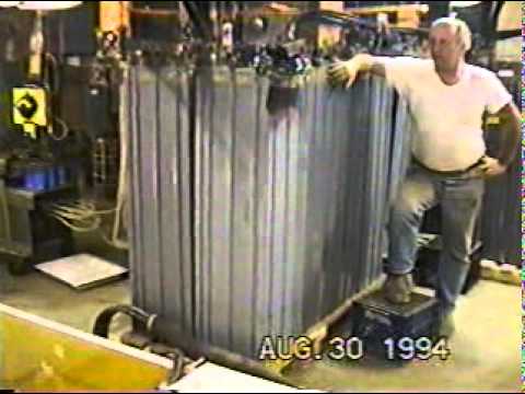

Here is a cool video using a single 2-volt 25,000 AH submarine battery making Ball Lightning. Note the size of the battery at 5:20 mark. In a submarine there is 300 of them in series.
