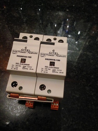

I shut down all the time until I installed these SPDs:
The Citel DS52VG-120s also have a built-in spark gap/thermal fuse so they're pretty easy to install. Also, when I put up my array, I used a soladeck roof mounted junction box that had a DIN rail so that I could do SPDs:
Here they are installed:
Since I use micro inverters, the only side that needs protection is the AC side. I'm on the fence as to whether I should be protecting the neutral bus as well or not. The neutral side SPDs are extremely hard to locate and also need a GEC to stakes driven in close to the array itself. Neutral/ground side potential differences are usually caused by (very) close strikes and the risk level here in WI just isn't that high.
Still todo: install low voltage remote status LEDs. I'll wait till the attic cools off a bit in winter before I run that wire. You can see the connectors at the bottom of each surge protector. The Citel devices have a DPST switch that flips if the fuse blows.4KW system featuring Suniva OPT265/Enphase M215Comment

On the AC side, the most important protection is between the two hot leads and the neutral. Just bypassing the two hot leads to ground will likely cause a high difference between hot and neutral which will then damage your equipment.Since I use micro inverters, the only side that needs protection is the AC side. I'm on the fence as to whether I should be protecting the neutral bus as well or not. The neutral side SPDs are extremely hard to locate and also need a GEC to stakes driven in close to the array itself. Neutral/ground side potential differences are usually caused by (very) close strikes and the risk level here in WI just isn't that high.
Whole house SPDs are installed at the main service panel where the ground system and the neutral bus are connected solidly together, so there is no issue there.
But when you place the SPDs remotely, as you have, you need to make an informed decision as to whether to place the SPDs between hot and neutral, hot and local ground, or hot and EGC (green wire.) Or some combination. Spark gap devices are limited in effectiveness compared to MOV devices and are, I think, more usually associated with protection from static discharge or direct strikes.
Opinions differ on what is best for general surges and for close-by lightning strikes, so read up on it, especially the instructions that come from the SPD manufacturer.SunnyBoy 3000 US, 18 BP Solar 175B panels.Comment
