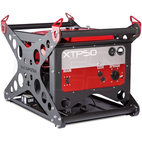

      current system
      Deutz 10 kw 3 phase generator running a franklin electric fps 4400 model number 20FA3S4-PE is the current system and the generator just blew up so if it is not practical to run off solar can anybody recommend a good 3 phase generator this size and 3 phase

        Here is a 5000W 3 Phase Diesel - 240 V 15 amps per phase and your pump by the nameplate is a 3 HP which draws 10.9 Amps per leg full load BUT the Starting amps on that motor are probably closer to 20 AMPs so a 10KW like you have is probably what is needed. Do you know the starting amps using an ammeter?
        5000W
        http://www.electricgeneratorsdirect....or/p17561.html
        11000W
        https://www.absolutegenerators.com/g...FYyRHwodAMMFuQ

          Do check if the motor is wired Delta or Y, to match up your generator. 120VAC neutral to each of 3 phases
          is 208 VAC phase to phase. 3hp is only going to run around 3KW or 1KW per line above, or 8A. A typical
          mechanical generator has some surge rating; I wouldn't design for a run rating of the starting surge. The
          rotating machinery gives some extra energy. My 8HP 4.5KW generator managed to start up a 4HP air
          compressor, yes everything dimmed and slowed but it worked. 2 HP car lift, no problem. Bruce Roe

            So it's a 3 HP pump? Why do you need 3 phase for a 3-HP? Might be better into looking how to swap the 3 phase for single so you can use any conventional generator. Per the Franklin AIM manual you need a 10KW externally regulated or 5KW internally regulated generator to start that pump.
            Also, Franklin does make a kit that converts a 3 phase motor into solar. Check these out: http://solar.franklin-electric.com/products.aspx#Tab4. Looks like you've already got the 3-HP three phase motor. Might look into what it would take to get this going. You'll probably save in fuel what it would cost to convert after about 5 years.
              VFD - Variable Frequency Drive
              You can get a electronic box that converts single phase, to 3-phase and soft start.
              article here at Mfg's site
              This is likely the easiest route.
