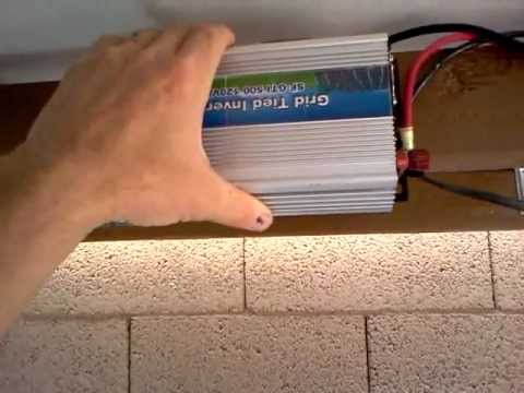

    I saw this system on youtube, video is below.
    I see harbor freight has a 1000 Watt Continuous/2000 Watt Peak Power Inverter for $79.00 and I think I can pick up a pump for a couple hundred or less. Judging by my kilowatt usage already, the total cost above is going to be less or about that on my power bill. I just don’t know enough about this to know if that inverter would work and if it will, what size panels and how many would it take to run all this.

        The problem with the video that Stay@home dad had in his post is that it is very misleading. It makes you think that you can throw up a few pv panels and use a cheap inverter so you can run your pool pump as long as it normally does using house power.
        There is no way you will even get a solar pv system to run your pump more than a few hours per day without a constant voltage output which usually involves some type of expensive battery system. The panels will only put out the correct voltage only if you never get any clouds otherwise without full sunlight the pump will be start and stopping all day long. The video also shows a very expensive variable speed pump which is much different from the one stay@home shows.
        Overall the cost to replace the pump & motor and purchase; panels, inverter, cabling, batteries, etc will be more than it costs to run his old pump for years even at $0.25/kWh.
