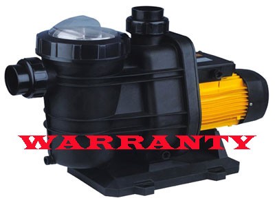

      Yes it is a 1.5 HP Davey Pump
      Will put a killowatt thingymajig on the Pump to see what it uses
      Don't want to go with batteries, too expensive, in Summer we get a lot of Sunshine and constant temps of between 36 and 41 degrees celsius
      Saw this on Ebay, same as I want to get
      Will post results of killowatt multimeter
      Cheers
        That is a standard pool pump - nothing to do with solar
          Thanks, doing more research and found relevant info on DC Pumps, sellers of these systems want $3,500 plus delivery
          Minimum requirement in Panels by One seller is 4x190 panels
            russ
            Your are correct except that is a really BIG pool pump at 2hp or 1500watts. I have a pump rated 1hp at 220v which I could never justify running on solar.
            I believe our sponsor sells Solar DC water pump kits but I don't know if they are rated for the salt and chlorine.
