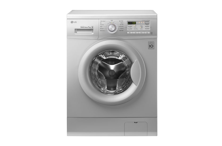

    Running modern washing machine on solar energy with 350W pure sinewave inverter
    I did a bit of research on running a washing machine on a small solar system this year (2013) and didn't get much up to date info. I have done it successfully now, so I thought I'd post the info here if anyone is interested as this was one of the better discussions on the issue:
    PV system:
    1x 80W PV Panel
    1 x 100Ah battery
    350W 12V Victron pure sine wave inverter
    New LG washing machine:
    Get more information on the LG F10B8QDP5. Click for pictures, reviews, and tech specs for the LG 7kg Silver Front Loader Washing Machine
    Cost: about US$ 450
    Energy Rating: A+++
    We run this once a week and it works perfectly. We run it on the following settings:
    *Main setting: Cotton Eco
    *Temp: Cold Wash
    *Spin: 400rpm
    water usage: 40L for 7kg load
    Total elec usage: about 100Wh
    Running time: 2 hours
    Peak energy usage (beginning of spin cycle): 250W (for a minute or so).
    Of course it is not possible to have hot washes on this system - the inverter wouldn't cope. And the spin speed mustn't be above 400rpm. The clothes are spotless after a cold wash - and I do lots of dirty outdoor work!
    I have another similar LG washing machine (8kg) that I use at our lodge - it runs on a 1600W inverter shared with 2 Bosch fridges and 2 AEG chest freezers, and that spins easily at the highest speed, 1200rpm, with a peak load of about 550W at the beginning of the spin).
    So if you want to get a washing machine off grid, go for a new LG A+++ machine and wash cold.
    Next project: dishwashing machine that uses solar heated water only (no heating element)!

                    hmmm... Two hours to do a load? Seems excessive.
                    I have a year old Maytag, 102L capacity compared to your 58L LG. Did a half load this morning and the maytag consumed 100Wh total, same as yours. Wp was much higher with it's 800rpm spin cycle but run time much less, closer to 45 minutes before ready to hang on the solar clothes dryer.

                                We generally do just one wash a week. I start the wash at 11am on a full battery and we're done by 1pm. By 2pm the battery is full again - I do have a cheap controller. I have installed loads of PV systems in the last 10 years and a big consideration here in Africa is cost - to a much greater extent than in first world countries. Here (rural village Africa), salaries range from US$100 to a maximum of US$400 per month (with 60% unemployment rate) and thus installing 200W of PV to generate 100Wh per week would be overkill.
                                Of course I will be lucky to get 3 years out of this battery, but at a cost of $100/battery that is acceptable. The forklift batteries don't really work in these small applications. Even the Trojan's are a problem as the cheap controllers max their absorb voltage at 14.4V which isn't enough to fully charge a Trojan which leads to one or more cells going "dormant". The only solution to this undercharging by cheaper controllers seems to be the very expensive controllers (MX60 or Steca Tarom) but then those cost more than the rest of the system combined! Hence the cheaper "deep cycle" batteries (I know they aren't really deep cycle) are best for the budget solar consumer.
                                I supply rural village homesteads with small solar systems that run lights, TV, small appliances for $690 including installation. In that price range, the considerations for sizing of panels and type of equipment used are very different.
