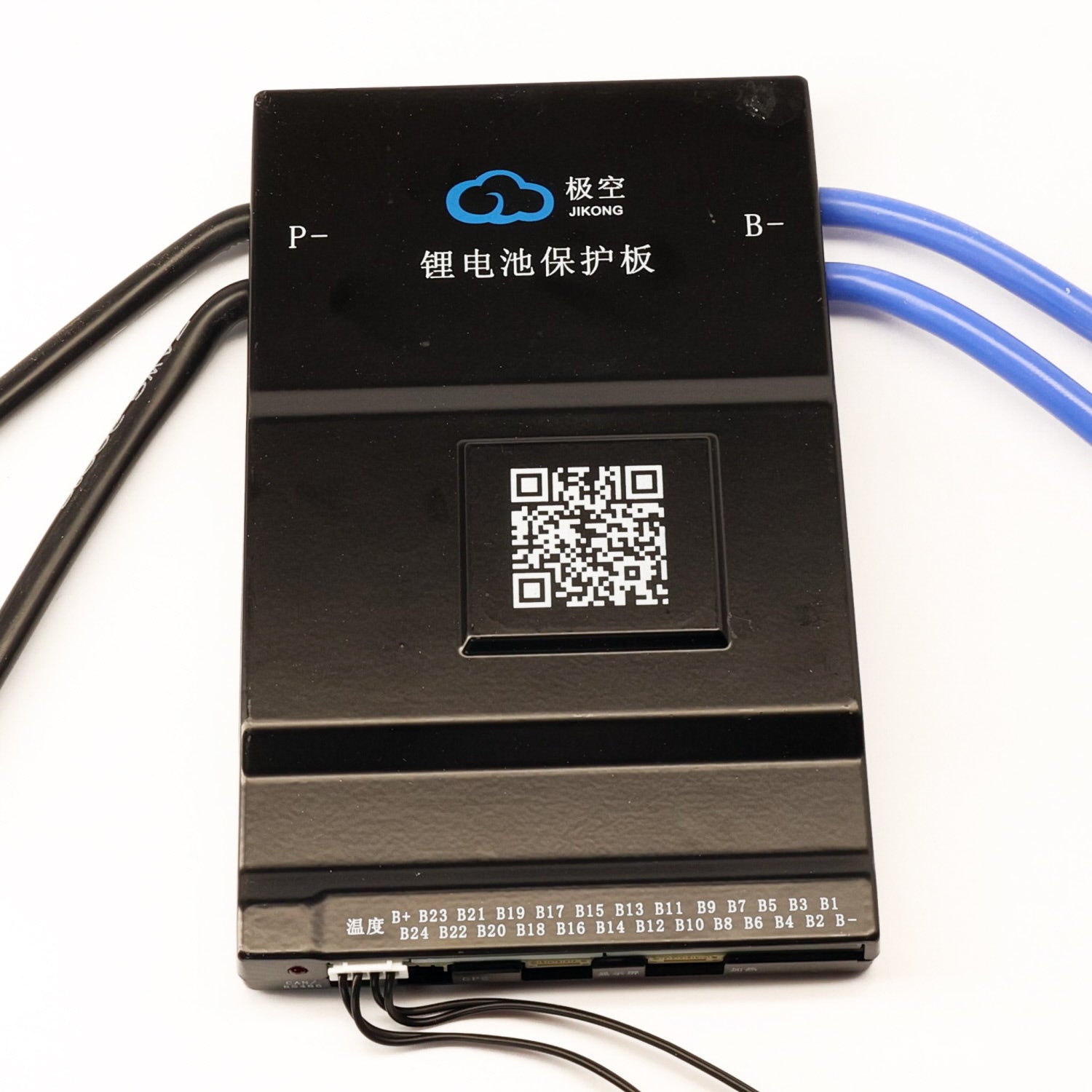

                          Well, I got started putting it together this evening…. Wasn’t as simple as I had hoped. He had already built a box (two put together) to hold the cells with threaded rods to be able to keep the cells compressed. I added the bus bars and cell wires (not sure what there called). Plugged them in. Connected my “power switch” which was bought separately not included with the bms. Connected the b- on the bms to the most negative post of the cell battery (just as on off grid garage with an alligator clip). Checked continuity and pack voltage on both the bus bars and the p1/p2 connectors that plug in to the bms. Everything checked out. Pressed the powe button… nothing. Held the power button down for 3,5, 10 seconds. Nothing. Checked/rechecked wiring. Nothing
                          So, I tried the 5v power supply across b- and p-. Still nothing.
                          Tried a 9v battery across b- and p-… nothing.
                          Did this numerous times, while pressing the button/holding button. Never got anywhere.
                          I have a 48v charger (picture added below) that puts out about 55.2v according to my fluke DVM. The pack voltage was 52.7v. I decided to connect it up as a charger. Negative to p- and positive to the most positive terminal of the battery. Still nothing.
                          With charger connected as described above, I held button down and LED Came on! and beeped! I was able to connect to it via Bluetooth and app on phone.
                          however, my concern is if I disconnect the charger, the bms goes off. This didn’t happen in the videos I watched. They all needed to have that initial start but then would remain on even after being unplugged. Why is mine not? My cells too low? The cells seemed very well balanced although definitely discharged.
                          I ordered a charger but it will not be here til Friday. What should I do? Wait to charge? Use the charger I described above?
                          Here are a few pics of the setup. Very messy right now but I plan to clean it up. The battery cable will be replaced with a larger bus bar also.

                                Ok, I guess my previous post that was blocked is not going to pass the spam blocker. I posted some pictures, I guess that's why??
                                So, to summarize. I couldn't get the bms to power on. I tried all the tricks with 5v and 9v external power supplies/batteries. Didn't work. I finally got it to come on by connecting a 48v charger to the pack and holding down the button.
                                Since that post, I figured out what my problem was.... My own stupidity. I had all the "sense" wires connected and checked .... all except the one that needs to go to the b+ on the bms. I didn't notice on the diagram that the most positive terminal or b+ needs two "sense wires" (b16 in my case 48v and b+). I assume this is because this bms is configurable with different numbers of cells. It seems this could be eliminated as well and only need the one b16 wire. Within settings of the bms the user could (and does) select the number of cells used. Why does it need the extra b+ wire? Not a big deal, but doesn't make sense to me. However, obviously it won't work without it....
                                Now to the initial charging. I ordered a "smart" charger designed for lifep04 (a relatively inexpensive one), but it won't be here for a couple of days. I do have the 5a dumb charger. What are y'alls thoughts on charging the batteries up with it? I'm impatient. I'd like to get this in the cart and at least see the cart move!
