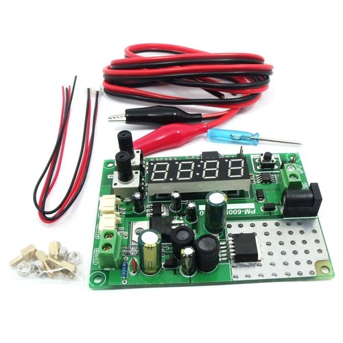

        Here another SEPIC with MPPT, sadly SEPIC is only ~90% efficiency compared to 98% StepUp/93-95% Step Down)
        Find many great new & used options and get the best deals for PM-6009M Programmable Buck-Boost Step Up Down SEPIC DC2DC Converter Power Supply at the best online prices at eBay UK! Free delivery for many products!
        Here some idea how to compine this SEPIC with Batterys:

                          No - the output voltage of a PV variies not just "a little"!
                          It varies just a little. Temperature changes output voltage slightly; if you make the panel 20C hotter voltage might drop by 5%.. Current draw changes a little more; you might see a 20% drop from open circuit to maximum power point. (If you drop the voltage more than that you are doing something wrong.)
                          That's why people use MPPT buck controllers, so they don't have to match battery voltage and panel voltage exactly.
                          Choose a panel or a range of panels. Decide if you want the PV voltage to be higher than or lower than the battery voltage. Choose a controller accordingly.
                          If you do not agree that it is smart to have some kind of buffer/temporary storage, so a stable current is guaranteed - Ciao.
                          Temporary storage = battery or capacitor. If you are a backpacker you are going to want a battery.

                              I have to laugh any time I see these MPPT schematics. It isn't only ebay that plays with the truth. That first link is to a MPPC controller. That is what happens when marketing takes over. MPPC is quite effective and I use it a lot in solar. Any cheap buck converter can be turned into a MPPC controller with only a couple parts. You are splitting hairs on efficiency. Again much of what you see posted is made to deceive, it is not a fixed number.
