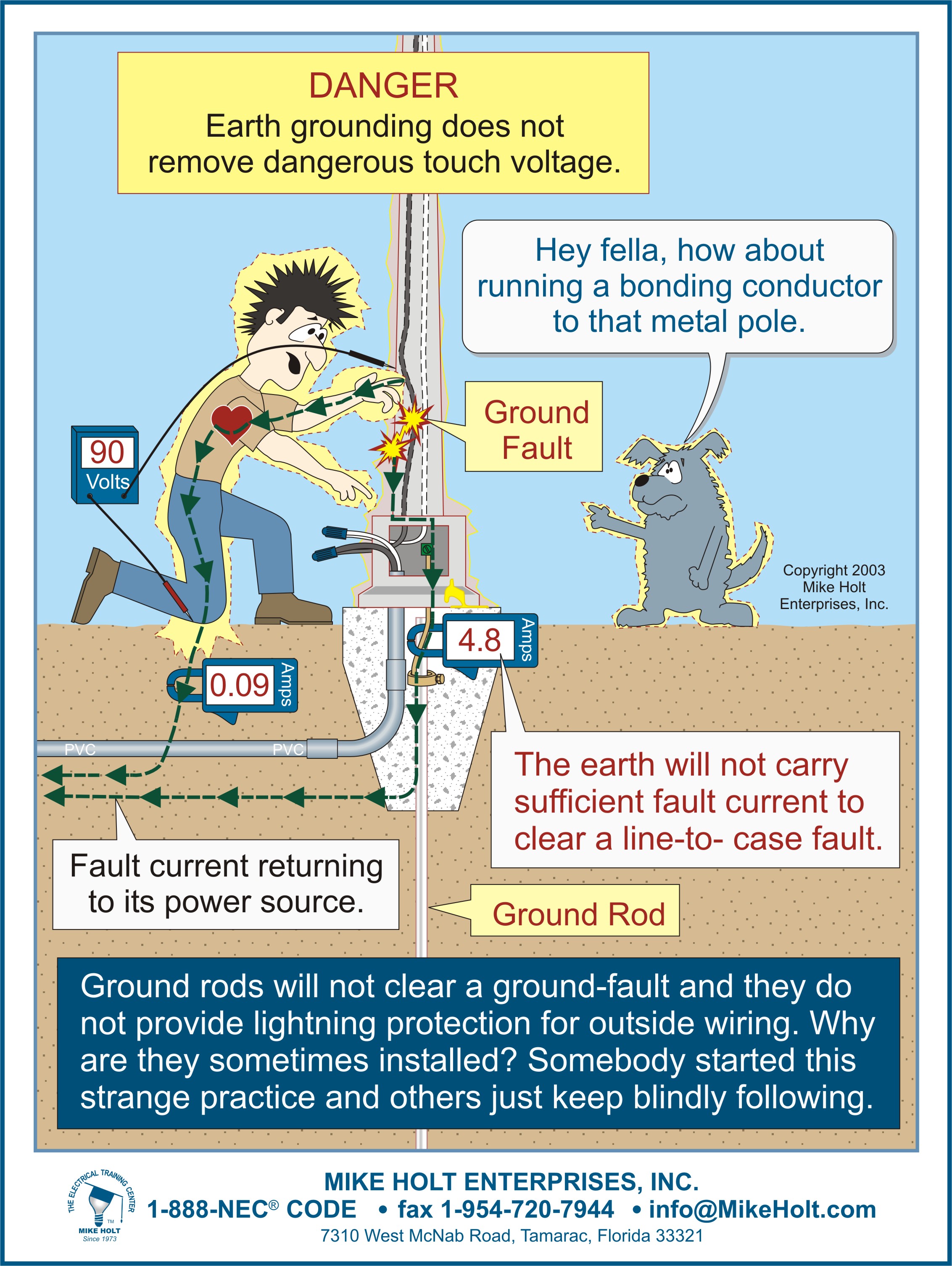

                    There is electrical ground in your service panel, and there are equipment grounds - like PV racks and arrays.
                    One is for shock prevention and other is to prevent lightning from entering your home
                    If you search on You Tube for " mike holt grounding and bonding " he is a author for some sections of the NEC and has many presentations on this confusing issue.
