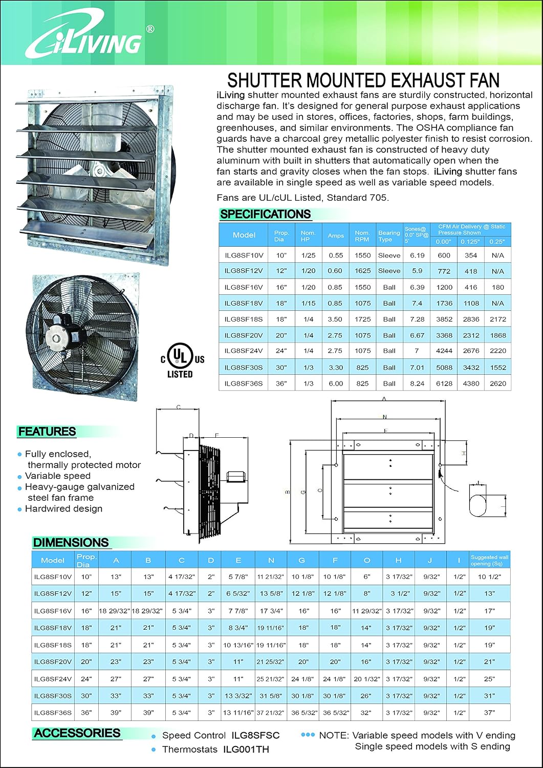

            I still do not know which fan you are talking about. Please provide me with the model number and voltage.
            Also is that pump running at 12V DC or 120V AC?

              the fan is ILG8SF10V. I have the battery connected to a 1000W power inverter and the fan and pump are plugged into it.
                • 15192
                Ok. That fan draws 0.55A at 120V which calculates out to about 66 watts.
                If the pump also draws 0.5A at 120v that also comes to 60 watts.
                With 4 hours for the fan that calcs to (66w x 4h = 264wh) and the pump at 2 hours comes to 120wh.
                So your total daily load is roughly 384wh. With losses that could easily increase to 450 wh which is less than what I calculated for that 180Ah battery.
                Now I see two issues.
                1st - that HF 100W system probably does not even get you 5 amps of charging and it will degrade a lot over the next 2 years.
                2nd - that 1000w inverter is probably consuming 5% of its rating all day long, which calculates to about 1200wh (1000w x 5% x 24h = 1200wh. Add that to your 2 loads and you are draining your battery almost down to nothing each day. You will never put back into the battery what you use to run your loads and inverter with only 100watt of panels.
