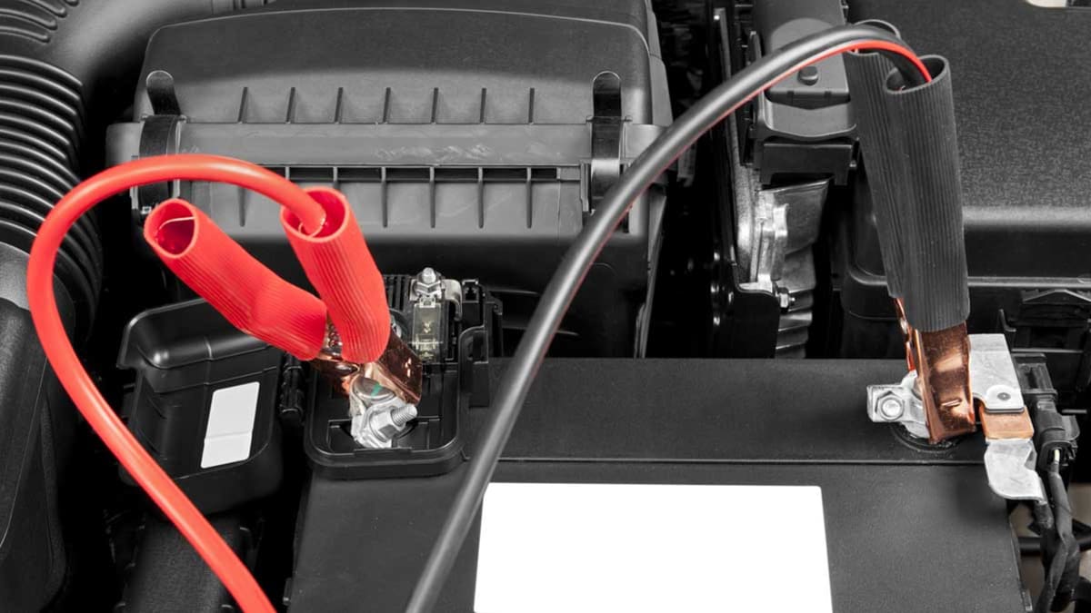

                        An alternative, is a Lithium automotive Jump Start pack, about the size of a large paperback. Find one with Cig lighter port & USB ports
                        Shopping for jump starters? Read about types, features, and other must-know topics in our jump starter buying guide to make an informed choice.
                        Much smaller and lighter than the laptop size lead acid packs. Or mount the solar panel, string the wires, and hope it's sunny enough.
