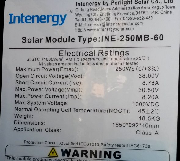

    Hi all
    my off grid system I'm building for my cabin.
    6 x 250W Intenergy mono panels. 38voc (planning to add another 6)
    Outback FM80 Charge Controller.
    32x 38AH gel battery wired to 48V (8 in parallel, four lots) = 300AH (14.5 kwh)
    APC 3000 UPS (48V)
    I'm trying to decide whether to have 3 PVs (114v) in each string or two PVs. (76v)
    Am i right in saying a PV voltage closer to the battery voltage will increase efficiency?
    And will I lose the charging power quicker in the evening with lower string voltage as it will get down nearer to the battery voltage quicker?
    Also a question about the PWM % display on the Outback, Am I right in saying if it is at say 60%, it is disconnecting the PV 40% of the time? Therefore not being very efficient? (presumably the PWM figure on the display the higher the better?) Thankyou!

      Those are nominal 20V panels. In order to have a high enough voltage to charge your 48V battery bank, you have to have strings of 3 in series for nominal 60V. The charge controller will then drop it down to the nominal 48V for the battery bank. You will not fully charge the 48V battery bank if you attempt to do strings of 2.

        Your controler is the flex max 80? If so the mppt range is 60-120v . As already mentioned 2 strings of 3 panels will work wonders. That's exactly what my set up is with different controler for 48v.
          Yes, but the effect with MPPT controllers is not as significant as it is with PWM controllers. The tradeoff is that at lower voltage, you'll have higher conductor losses. As others have stated, strings of three would be the right choice for this setup.
          Lower sunlight reduces current, it does not reduce voltage. With either string configuration, the charging power available from the panels during bulk would be the same, as long as the voltage is in the MPPT range. Again, as others have pointed out, with a 2 panel string, you will probably fall out of the range.

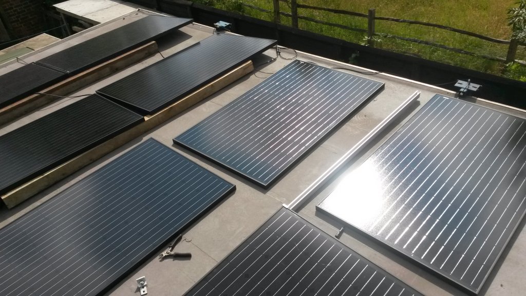

                Thanks for replies. The Vmp of the panels is 30v
                Today I have connected them in strings of three. (Two strings.. 1500w total)
                Todays measured peak watts was 1400, while the washing machine was on. (Washing machine was consuming up to 1700 watts, mostly becuase of the heater but I then switched it to a cold wash as it was hammering the batteries.) Good test though.
                I already have 8 panels so if I buy just one more I can have 3 x 3. (2250Wp)
                Not got as far as mounting any yet

                    Aren't you worried about a high wind taking those panels for a "trip" or do you have a solid attachment on both sides of each panel?
