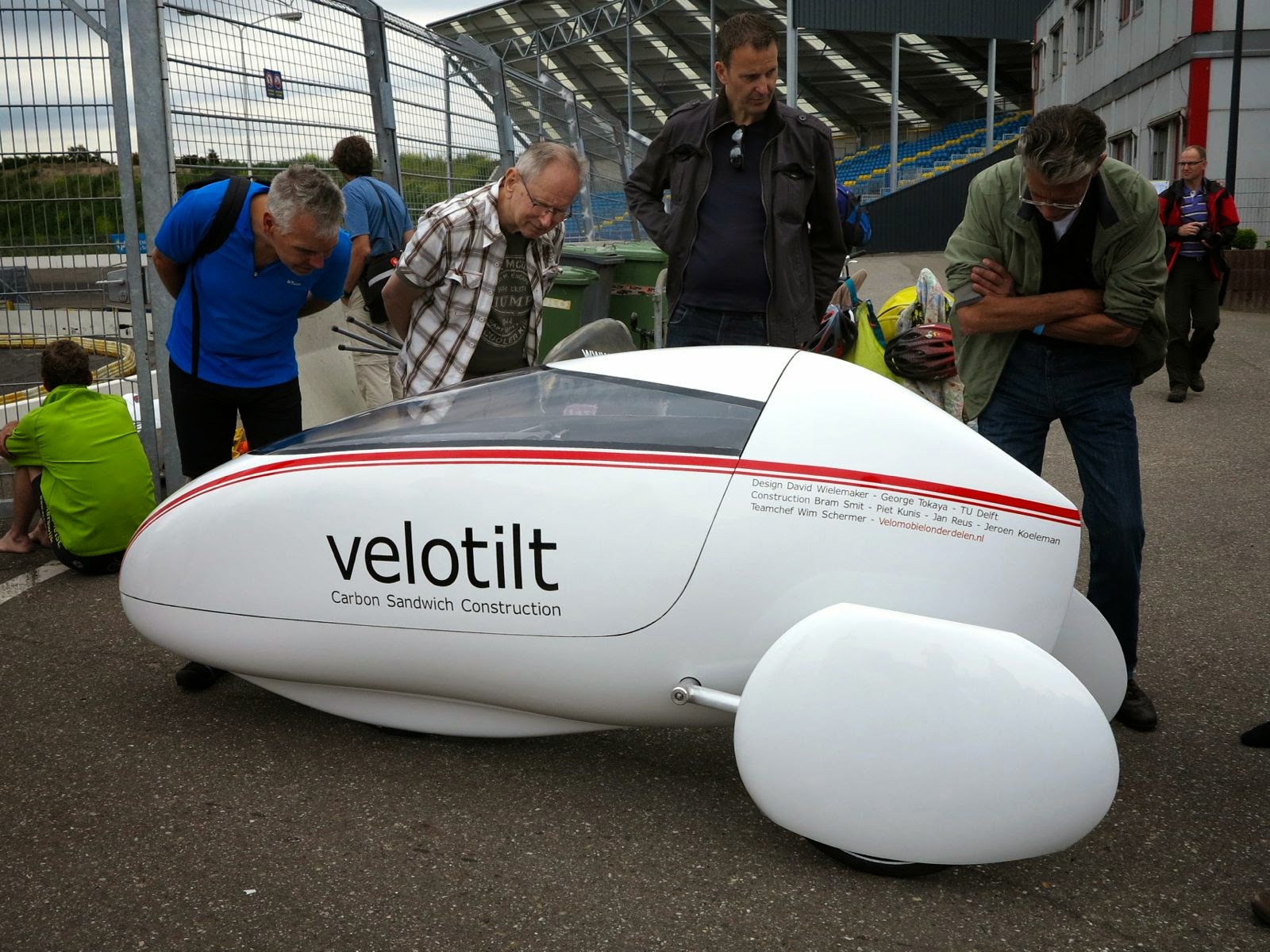

    Where shall I start?
    Reasonable for a 100 pound curb weight vehicle
    Sure you can buy them I did it. A 92 volt 90 AH battery weighs 220 pounds and is about what DIY EV cars use. In my case a golf cart which is over kill. Capacity and weight are directly related to each other. E-bikes use 36 volt 10 AH batteries that weigh about 6 to 7 pounds with a capacity of 360 watt hours. A 92 volt 90 AH battery weighs 220 pounds with a capacity 8280 watt hours. You cannot get around the energy density of 100 wh/Kg. Do the math.
    A 8280 wh battery to be recharged in 1 single day with a 4 Sun Hour day takes 8280 wh / .9 efficiency / 4 Sun Hours = 2300 watts of solar panels. Very simple 5th grade math
    An E-bike 36 volt 10 AH battery to recharge in 1 single day will require 360 wh / .9 eff / 4 Sun Hours = 100 watts
    You can pretend all you want, the math and physics say you are nucking futs.
    Do you want to talk about how much energy it requires to take a mass and accelerate it to X mph in x amount of seconds, and how much energy it takes it to keep going X mph? I bet Mr Newton would love to hear your method because James Watt is rolling with laughter in his grave right now.
    Weight has almost nothing to do with it. It's all about aerodynamics. Sure, you lose energy as heat when you accelerate and then regen brake; about 25% of KE in my case, so about 10 watt-hours lost to ride up to 88mph and immediately brake back down. But aerodynamics are what really bite you. In my simulation with my controller, battery pack, motor, and tires, the difference between my fairing and a typical DF bike at 40mph is 2.6kw; 900 watts in the first case, and 3500 watts in the latter.
    What chemistry are you figuring that off of? Here's a datasheet for the 18650 cells I will be using. Keep in mind, if charge rate and longevity wasn't a concern I could have switched to 3.4 ah Panasonics which would net me 11.3kwhr with about the same weight. With spacers and wiring they should still be under 40kg. Batteries are getting better all the time and NMC/NCA are no exception; you need to update your numbers. Packs around 200wh/kg are already available, and these use cheap, large, and heavy BMS's, unlike mine. There's a reason Tesla uses 18650 format cells.
    Like I said, I don't expect that battery to be recharged in a day. I'd only like to get a few hundred watt hours of charge each day. If I need it charged fast, I'll plug in-- but that'll only be necessary on long trips. I never said anywhere I expected a full charge in one day. ELF rates their single semi-flex 100W panel at 568wh/7 hours, or 300wh/4 hours of sunlight. It's not unreasonable to expect the same performance from a system with four times the surface area.
    Check your numbers, run them again, and if you still need me to explain to you why they're wrong, let me know. I'll be around.
      For the fairing on your bike - count maybe 10% of the panel rating - I still say you are smoking something. This is not real.

        Why so low? Like I said, I'd be happy with 18%. The ELF has been praised, despite the fact it has the aerodynamics of a wall and its low-end electric components have about twice as much waste heat as mine... A consequence of it's shape means that it is left with room for only a single 100W panel. That is enough for some people despite it's inefficiencies!
        Tilt is important, but it's not 90% of the game... according to sources I've read, daily yield will be 30-40% higher by matching tilt. I see no other challenges in this case other than developing my own electronics.
        @SunEagle; Thanks. Yeah I did wear a full-face helmet on that 70mph run, and it was on a 2% downgrade so it doesn't really count. I can get 63mph solid though, and stay over 60mph even up a 10% grade. Voltage limited speed is only 43mph with that bike, I have to use field weakening beyond that which requires a tremendous amount of power (up to 25kw total). It needs smooth roads, thankfully they're almost all brand new in my town. But the bike needs to be improved anyway =)
        If I simply told you I was mounting fixed panels on a canvas or fiberglass, I seriously doubt I would be getting so much negative feedback. I suppose you think EV's are eclectic and shoddy, and that a homebuilt EV would be worse than a commercial one, yet it is the DIY EV's that are most impressive. Why would these panels be worse off in a fairing than on top of a boat?
          Tilt and orientation - you are going to get little to nothing. No big deal - the concept is foolish.

                  I understand that different cell-to-cell insolation can really kill a module, and a shaded module in a simple string can bring down the other modules, but isn't that what diodes between modules are for? In fact, I actually planned to build separate MPPT's for each side. They are not very flexible so the cell-to-cell insolation in each module will not be very different in the absence of shadow; the ELF's panels are laid down along a 30-degree arc, yet multiple reviewers have stated even just 6 hours in ideal full sun is enough to net a full charge, though the official rating is 7.
                  I'm not familiar with these semi-flex panels outside of real-world applications I've seen like the ELF and their datasheets, and I know that's not always a perfect representation. But it tells me that this is certainly possible, and that's not what I'm hearing here, but I haven't seen any substantiation. So forgive me if I'm dismissive of your and others input, it's because I haven't seen any numbers or reports from anyone here and my own searches seem to indicate its quite possible.
                  People have suggested adding solar panels to EV's for a long time, but it's always been a pipe dream because electric cars use so much power that it simply doesn't matter. You might get a mile of range a day, parked in the sun... But I'd be using less than a tenth as much power and live in a small town, so it's not so inane. If I had simply told you guys this was for a trickle charger on a replacement hood for a VW Bug, would that have been as crazy?
                  Whatever you decide to use to mount those panels please take in consideration the additional drag and loss of aerodynamics. Having a sail in front and the wind in back works for sailboats but having a parachute in back for a bike is a drag.
                  With panels on top of a boat you have a higher percentage of them getting more sun due to lack of shadows being cast on them. When the panels are lower (like on a fairing) the chances of getting shadows (from the bike rider) is higher which hurts the amount of energy those panels can produce. Your 18% may be a high estimate if you bike into the sun. And there is no guarantee that even if the sun in behind you those panels won't get some shade.
                  I planned on laying them up right over my carbon fiber, and bagging them in Sylgard-184, so they should be an integral part of the fairing... I'm not sure I explained my intentions well enough, but they would be running lengthwise along the fairing at a relatively shallow angle, likely less than 30 degrees. I can imagine the case you described depending on the angle of my rear panels.
                  I couldn't really shade the panels while riding, though. A picture will make that clear. My fairing will be somewhere between VeloTilt and the Rocket project, but with a more upright seating position than the Rocket and a wider fairing than perhaps either; I want the cargo space. These bikes are in the .1 square meter CdA range, Velotilt is certainly less. And I'd be happy with .15 instead of .7! As you can imagine, with a lower front and wider sides, there would be a lot of very flat area for mounting panels and it could be made even flatter. And depending on how often I ride, yes, I could park it at an angle for temporary peak production from one side =) According to reports from VeloTilt though, I believe their tilting geometry is quite poor; their center-of-gravity lowers faster while leaning than a linear track vehicle would, that is, it is unstable. I will use swingarm and rocker offsets to achieve the opposite effect.

                            I'd actually have to pedal for 1.5 to 3 hours to produce 300wh of energy! Most riders fall into the 100-200W range. I can float near 200w for at least an hour, but it's definitely work. Pedaling for your energy really puts the consumption of climate control or a car into perspective and gives you a healthy respect for power. My battery pack will hold the equivalent of 7,000 Calories of energy, but the body is only 20-25% efficient...
                            I don't think I'm misinformed about PV characteristics.
                            There are some papers from '91 into the 2000's detailing the losses at various angles of incidence. They found that the worst result was a 30% yield of what was geometrically expected at a 60-degree angle of incidence, that is, ~15% of rated output at a 60 degree angle. In this example, angle of incidence is degrees from perpendicular; that is, θ = 0 degrees = 100% production. So this example is a pretty sharp angle. The amount of geometrically expected production is cosine(θ). This site has a good interactive animation of this effect at the bottom of the page that accounts for the reduced efficiency at these angles. Please note that the default latitude is zero degrees, and as I live at 45 degrees I'm actually in a great situation to mount them at 30-45 degrees on my fairing. Output is pretty low after 45 degrees but not too bad before that point, and I could not possibly see an incident angle greater than that in more than half my panels at any time.
                            I may work on the model some over these holidays, but I'm away from my desktop and don't like to model off a trackpad. I've been changing parts of my sketches too quickly over the last year to keep up in Solidworks but I'm beginning to settle on all those details.
                            Maybe in a year or three I'll be able to come back here and show off a finished product... I enjoy fabrication so I'm not in a hurry, and there are many minutia such as this charge controller that can easily consume months of time. But it's a long way off.
