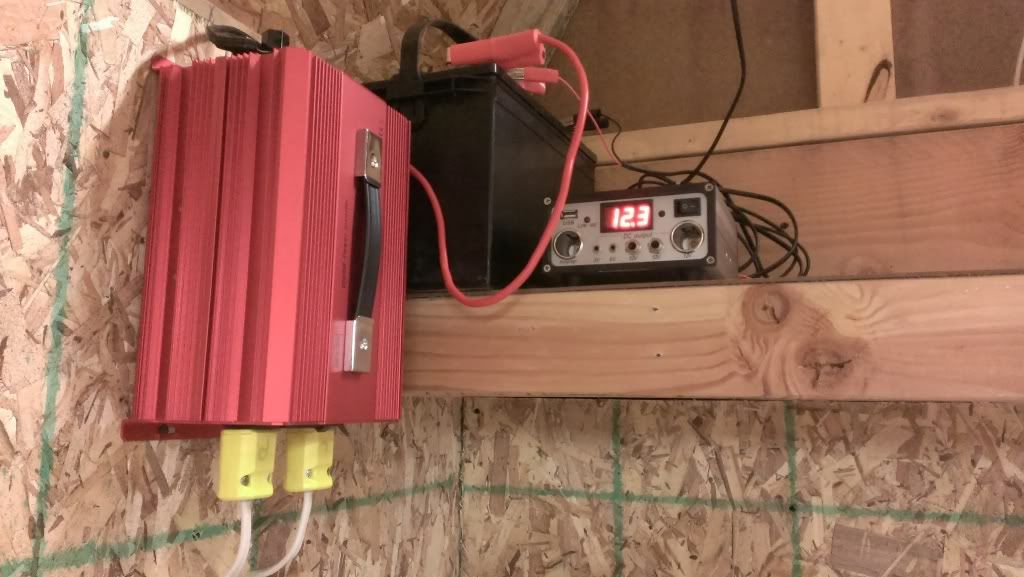

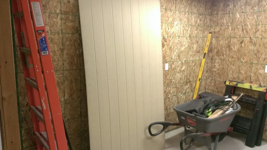

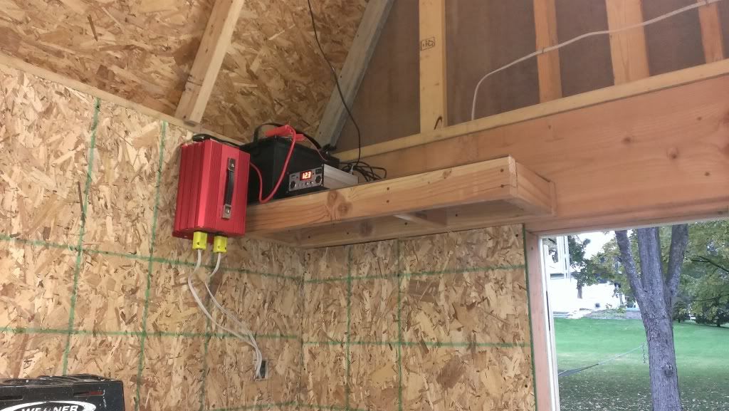

      Well, I thought I would post an update. Finally got the inside finished and the shelf up for the solar equipment inside.
      Here it is. One plug for the lights, one for the wall sockets.
      Closeup. Charge controller to be replaced. Borrowing the HF stuff for now. Hey, it works.

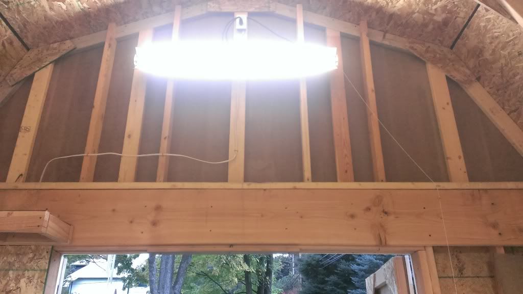

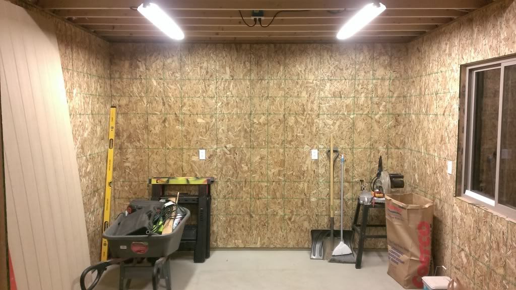

      Lights on nice and bright. Can't tell a difference from the extension cord...

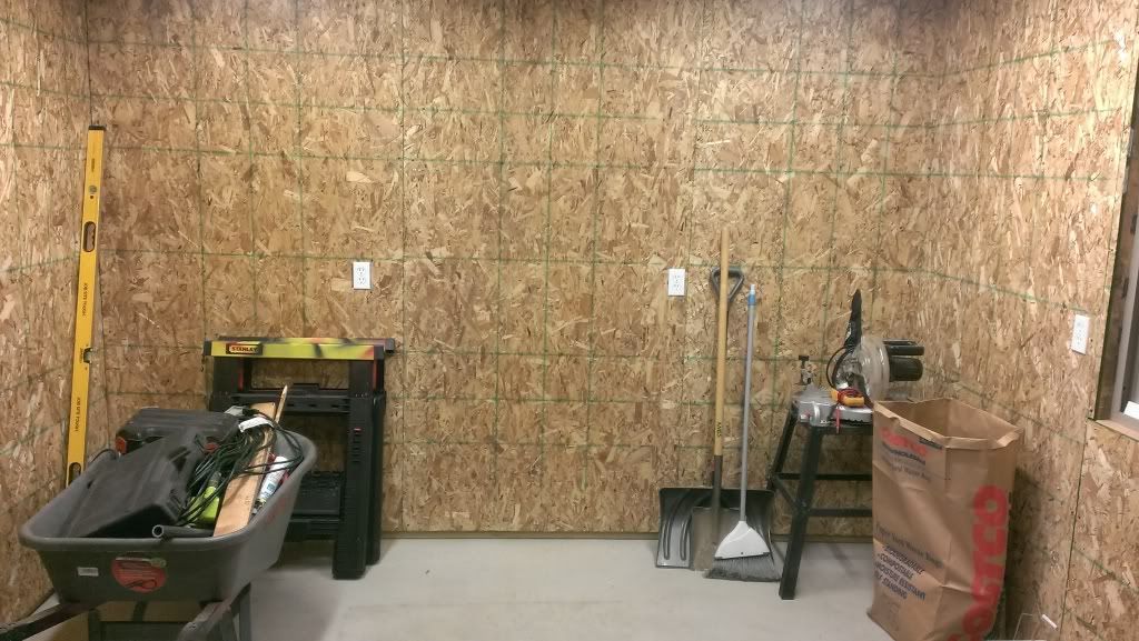

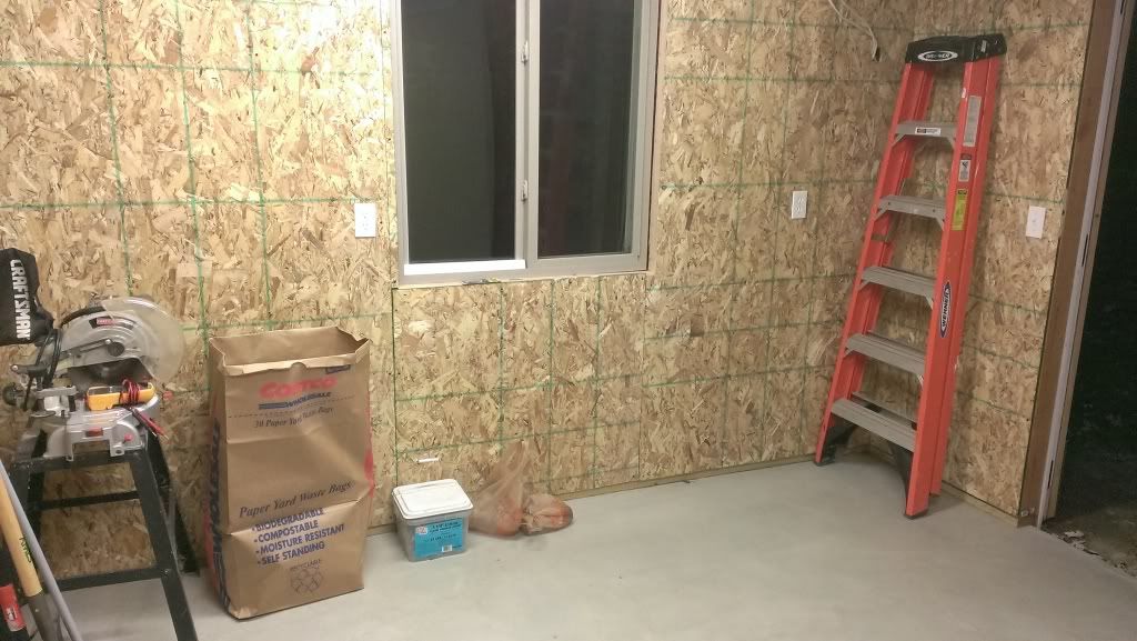

      Each wall and the outlets available. More than likely will be used to charge the lithium Ryobi and the DeWalt 18v batteries for the most part...
      The finished product for the charging setup will include a digital volt/amp meter that I am thinking about wiring in to be able to switch from incoming voltage/amperage to outgoing voltage/amperage so I can see what's coming in and what I'm currently using. Not sure if that will work or if it will blow things up, but I'm going to read up on it. Any thoughts on doing this?
      With the current charge controller, we had the 3 lights on for a solid hour at dusk when the panels were hardly charging (though, still seeing voltage) and the controller started out reading 12.9 before turning any lights on. By the time we shut down for the evening, it read 11.9. But as soon as I shut the lights off it jumps to 12.1-12.2. What is this telling me? Anything really without knowing my amperage I was drawing?
      Also wondering, will the inverter be alright hanging that way? The cooling fan is pointing up, but I've yet to see/hear it kick on anytime other than start-up for about 3 seconds. This mounting position works well since the inverter switch is within reach of anyone walking in. Open the doors, flip on the inverter, flip the light switch next to the door, and let there be light!
      Anyway, that's what I have for now. Comments are welcome. Thanks for the informative posts thus far guys! I'm having a lot of fun with this setup and reading this forum is invaluable.
        As long as the inverter cooling air exhausts uphill (enhancing the chimney effect of hot air rising) it should be OK. (properly designed fans, should be intake fans at the bottom, with cool air flowing over the fan, not like many inverters with exhaust fans on top, all sorts of toasty)
        But, I sort of think that clip on leads to the battery are bad.
        Having the battery up so high leads to :
        a) running warmer and dieing sooner
        b) hard to check and add water monthly
        c) fuses on the DC side ?
        Is the inverter sine wave or modified square ? Most modified waveshape inverters don't work well wired up as "house wire" with a bonded neutral to ground. If you ever get something that bridges the neutral to ground, the magic smoke is released and you get to buy a new inverter.
        If you are planning on replacing the inverter anyway, look for a model that can sense an applied load, and automatically turn itself on. It may take 5 seconds to respond to a light switch coming on, they only look for loads at intervals, not continuously.

          Yeah, I knew I was going to get some heat from some people about the clip on leads. They are temporary. My battery has a threaded post and came with a couple of hex head nuts. It's just a matter of my getting my wire cutters/strippers out and crimping on an eye-hole onto them. Since my charge controller is even more temporary, those clip on leads will be gone and the new controller will have homemade wiring also with eye-hole connectors.
          I can't find anything stating exactly if it's pure sine or modified but one of the Amazon reviews is stating that it's modified. I will have to check the paperwork I have on it when I get home. That would be nice if I could get one that recognizes a load so it will flip on automatically. For now, it's a two step process. I might check to see what the inverter pulls when powered on, but with no load.
          Fuses on the DC side? There is a fuse on the inverter between the battery connection on the back side (top in the photo). I forget what amp fuse it is...
          Regarding the battery being up so high, I don't see it being a big deal to check/add water. I have an 8ft step ladder that gets me right up there. Easy peasy. It's out of the way, and I can't hit my head on the shelf. This shed is 12x12, but it's going to be getting filled up quick and I need to make sure I utilize every inch that I can. As far as it dying sooner due to heat, etc. I'll see how the heat is next spring/summer. Our high temps this week are in the low 50's, and it's not looking up until...March or April? So I'll check on that once we get our temps back.
          Edit: Also wanted to add that I was doing some math this morning about my "usage" just going on what we did last night. We ran 3 lights at 64w each for 1 hour. Here is what I came up with:
          64w * 3 = 192w
          192w / 12v = 16a per hour (correct?)
          So, with a 104aH battery, using 16a/h gives a discharge rate of about 6 hours (rounded down). Does this put me at a C6 on the Peukert Law?
          The current setup is not recharging at a significant rate to make up this difference so I'm really glad I have the 100w panel coming with an MPPT controller.
          Can anyone shed some light on my idea for the digital volt/amp gauge?

                  I don't see any grounding, fusing or disconnects. Do you plan to install any of those safety features?
                  1150W, Midnite Classic 200, Cotek PSW, 8 T-605s
                  • unt0uchable
                    • Oct 2013
                    • 35
                    I'd like to. Could you give some recommendations on how/where to go about implementing some of these?
