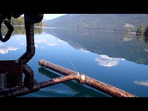

                              I think my last build worked out pretty good and I have been spending more time on the water and not much time working on it. A few days ago I explored a nice lake high up in the Cascade Mountains. Here are a few pictures and a short video from Lake Kachess. Hope it inspires a few people to push forward with there solar boats lake Kachess 1.JPGLake Kachess 2.JPGLake Kachess 3.JPGLake Kachess 5.JPGLake Kachess 6.JPGLake Kachess 7.JPG
