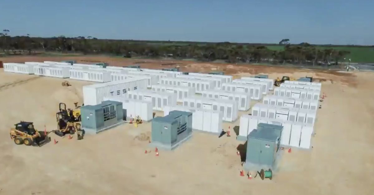

Yes, they over exaggerate the shortcomings of Lead Acid.
The big players in grid storage are all using Lithium. I believe the future is Lithiun but Lead Acid is still a good value for smaller systems.
These kind of players in the Lithium space tend to be overpriced. That is why they need the hype.
Last edited by Ampster; 08-11-2019, 11:40 AM.9 kW solar, 42kWh LFP storage. EV owner since 2012Comment
Really? PV Powergrids (offgrid) are using lithium??
Second life lithium, like @ the Ayax Football Stadium in Amsterdam Europe's largest second life lithium bank, or are you talking about newly bought lithium bank?Comment
