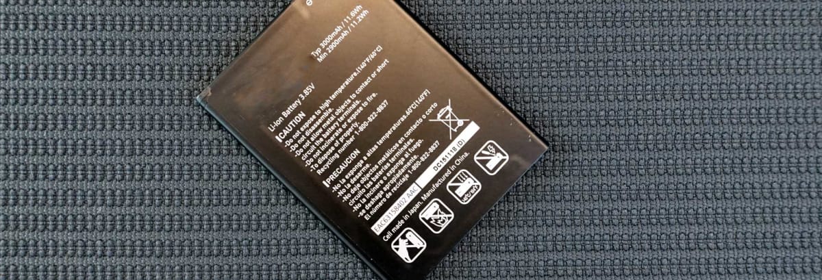

Car batteries are generally higher energy density, LFP (LiPo4) are safer.
As replacements to the recalled Samsung Galaxy Note7 arrive in stores, Consumer Reports investigates what's next in safety for lithium-ion batteries.
