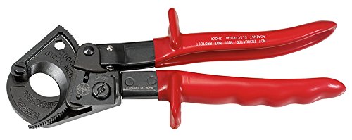

Here is one of the Ratcheting cable cutters. They are OK if you are terminating to a mechanical Terminal, but not worth a darn on Compression Terminals where tolerances are tight. As you noticed you cannot get a flush, squared, plumb, and clean cut. They will set you back some $500.
Band and hand saws are very accurate and clean cutting.
