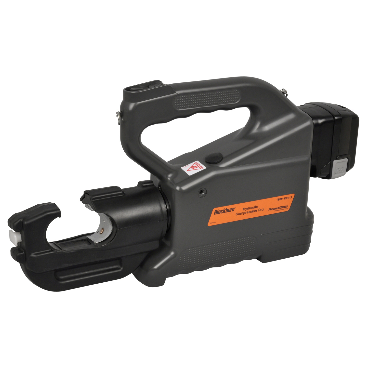

                              250 Amps DC, for a 3kW+ inverter @12V? It may be common somewhere, but I wouldn't want it in my house. When you start talking about 2000 or 3000 Watts, at 12V, the current becomes unwieldy and all the wiring associated with the PV and batteries is going to have to increase to larger sizes. And it requires larger current capacity charging equipment too. I'm new to this, but those are my thoughts.
                                Copper cable the size of your wrist and takes a $3000 15-ton hydraulic compression tool to terminate that kind of cable.
