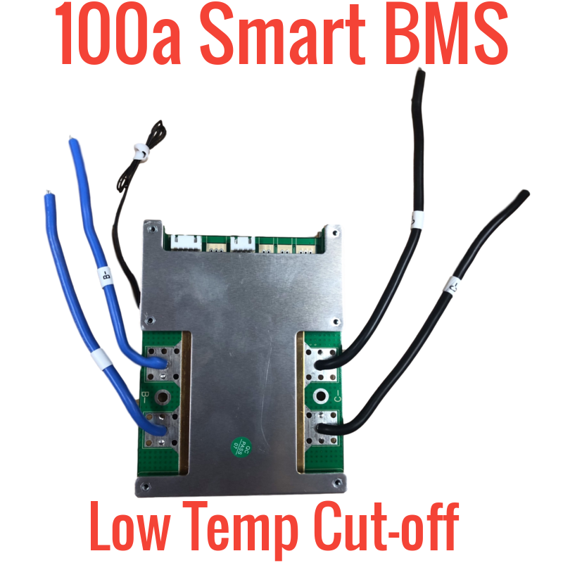

I want to build a 48V pack and there's only one BMS I can find with a low-temperature cutoff that's affordable, and they're out of 13s right now. Can I use a 14s?
Can I use a 14s lithium-ion BMS on a 13s lithium-ion? NOT lifepo.
Can the BMS be reset to work at a lower ( 13s ) voltage so you don't fry your batteries if overcharged ?

Yes, it may be able to report individual cell voltages. The question asked above is whether the total voltage will be correct. This clearly could affect Low and High voltage cutoff settings.
You answered your own question, so give it a try and report back. There are many BMS options out there. The one in the link says 3S to 20S and your post says 14S. Are you looking at a different model?9 kW solar, 42kWh LFP storage. EV owner since 2012Comment
I need 13s, lithium-ion capable, 48V total, 100A capacity, don't need Bluetooth (nice but not necessary), with low-temperature cutoff. I've only found two BMS with that spec, the other is more expensive and doesn't seem to offer any benefit over this one.
Other thing I may do is get one of the more common BMS without low temp cutoff, set up an Arduino with a temperature sensor and a relay. Need a beefy enough relay though.Last edited by cdevidal; 10-06-2021, 01:51 PM.Comment
