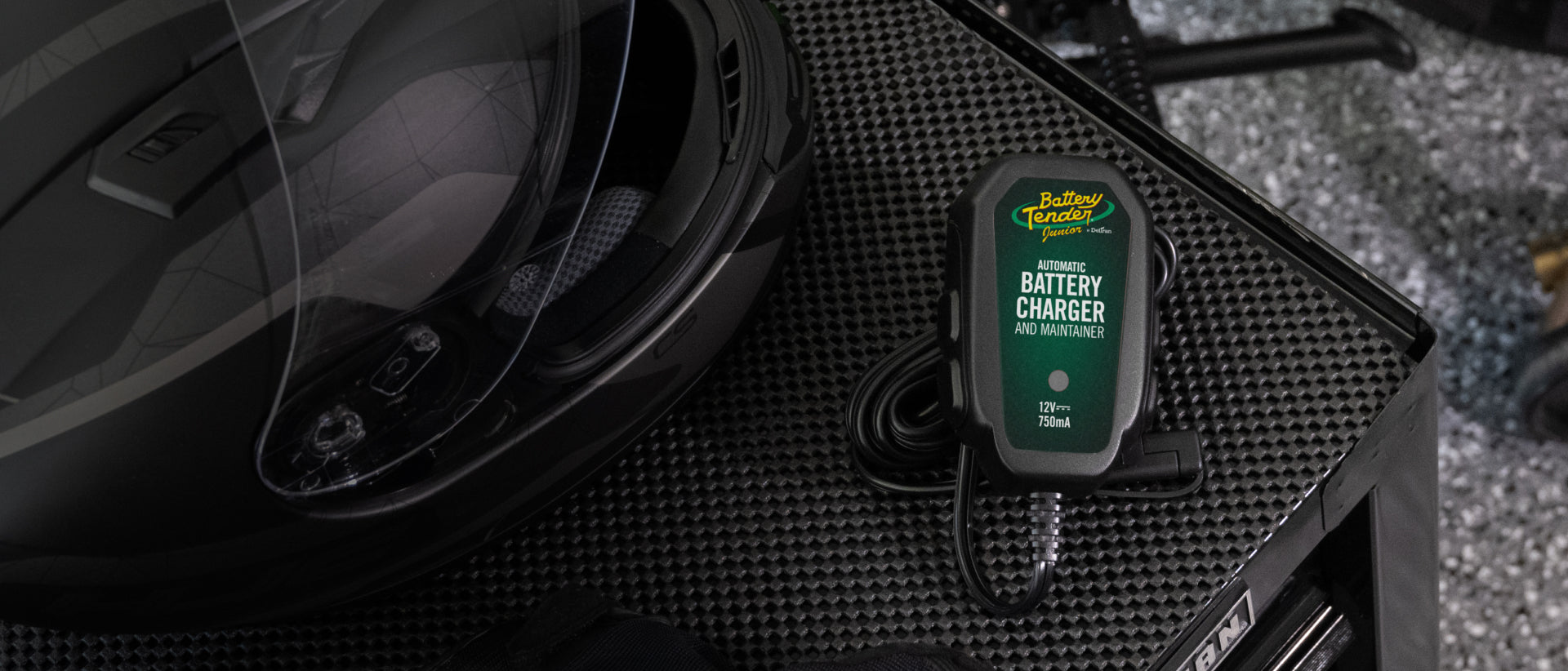

        Any thoughts on the Deltran Battery Tender family of products? I've been happy with them for my 12V battery use. For example:
        America's #1 smart battery charger brand since 1965. Shop 12V, 6V & multi-chemistry automatic chargers for cars, motorcycles, boats & RVs. Free shipping over $50.
        They make other models as well, higher and lower current.

          For the battery tender by Deltran, I can’t find the 40 amp one to make 10% to charge all four on one charger. The do have a 5 station 6Volt charger with a four star rating at twice the price of the Noco G4 I mentioned which has 4.5 stars. THe battery tender only makes a couple of 6 volt units, and looks the strongest one is the 5 station one I mentioned at 4 amps.
          I’ve got Battery Tenders charging my 4 batteries at my house.
