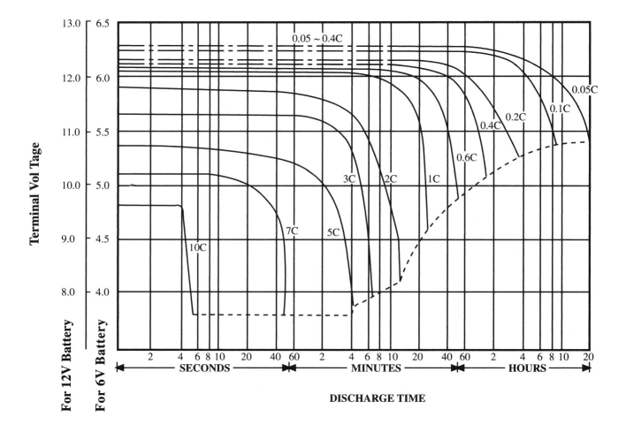

                  Yes Watt-Hours is energy, not AH ( my mistake ) rephrase
                  At high amps, the energy consumed by the heat is GONE.
                  At high amps, your battery is less efficient at delivering the Amp-Hours to the load, as some is also going towards heat.
                  At high amps, the internal resistance of the battery becomes significant and introduces I^2xR Heat Losses into the equation
                  At high amps, you battery will be warm <= that is where your "lost" Watt-Hour energy is going and it is not recoverable.
                  Chart Below...
                  Let's assume C = 20AH and the knees are "square corners".
                  I approximated the area under the curves to calculate Watt-Hours for three discharge curves, as follows ...
                  At 0.05C Rate = 200 Watt-Hours = 12.5 Volts x 1 Amp x 20 Hours = Very efficient & battery is room temperature
                  At 1C Rate = 121 Watt-Hours = 12.1 Volts x 20 Amp x 0.5 Hours
                  At 7C Rate = 19 Watt-Hours = 10.2 Volts x 140 Amp x 0.0133 Hours = Not efficient & battery is very warm
                  If the resistance of the load and the internal resistance of the battery are equal then
                  50% of the battery's Watt-Hour energy is dissipated / wasted as internal heat energy.
                  NOTE:
                  The X-Scale is not linear ( logrithmic scale? )
                  Linear "Minutes Section" should be 60 times wider than the 60 second section!
                  Linear "Hours Section" should be 20 times wider than the stretched 60 minute section!

                            This battery actually recovered with a good recharge, yielding 210Ah on the next C20 discharge. So we did 3 more repeat tests, comparing discharge to 10.5 V the 10 Hr and 5 Hr rates.
                            The results were the same each time : discharging at a high rate to the 10.5V then allowing a rest, would result in OCV recovery, allowing further discharge at a lower rate, always giving a total yield within a few Ah of the C20 capacity
                            I've also since seen these results echoed in several other working setups I've helped build people over this time, including my own.
                            In the case of my Fullriver DC400's, I can pull roughly 120A for an hour while cooking and heating the shower, before inverter starts to complain about apparent batt V. The spec sheet lists 126A as the 2 Hr rate, meaning by rights, I've used 50% of the batteries capacity this way.....but my monitor says I've really only used about 30%, based on the 415Ah C20 capacity.
                            Here's the thing - turn it all off for about 20mins, and the volts jumps right back up to about 12.4v - more or less where the DC400 spec sheet says it should be for for 70% SoC. And I can keep happily running normal loads for hours after, and never see it drop under 12.1...at least not until the monitor says I've actually used 50% of that 415Ah .
                            So, wrapping up:
                            The results here confirmed what I suspected initially - Peukerts Law is describing an effective loss in capacity with increasingly heavy loads, as the induced voltage sag hastens you towards the 10.5V 'cliff'. It does not, in fact, reflect energy losses due to resistance/heating/magic - while there is indeed some energy lost to resistance, it is nowhere as large as this, which can be confirmed with a basic sanity check below**
                            Peukerts law CAN be used to accurately estimate your usable capacity at any CONSTANT given rate of draw. However - if you have variable loads, you're perfectly OK to figure out what capacity best corresponds to the 'typical' draw over time, and just use that. Any Ah used by intermittent heavy loads just comes off this C20 total, as the V will recover once the heavy load is withdrawn, leaving you free to continure draw at your 'typical' load
                            The only issue crops up is when you've used up a good portion of that C20 total, and THEN try to pull a high load. If you've already the equivalent of your C2 rating, but at a lower draw, trying to then pull C2 at 40% SoC will sag the voltage to 10.5v right away. In that sense, as far as those heavy loads are concerned, you've used all the battery can give.
                            **If the difference in AH yield shown by Peukerts Law was lost energy due to heating from internal resistance, then in the case of my DC 400 batteries, comparing the C20 rate (415 Ah) to the C2 Rate (240Ah), this would mean that if I used 240 Ah @ 120A for 2 hrs, versus 20A @ 12 hrs, I would have "lost" ~175Ah of charge as internal heat in the batteries alone.
                            That is an INSANE amount of energy. By comparison, it take about 40Ah for me to BOIL my 10L water heater. 175Ah would do that, fours times over, and then some. I'll let you do the math on the joules if you want, but suffice to say, if this WAS the case wires would be smoking and acid would be boiling. Having now personally tested this exact scenario, I can say thats simply not where the energy is going.
                              Well your conclusions are wrong based on junk science. One fact you missed is heat losses from resistance has absolutely nothing to do with Peukert Law or Amp Hours. You are making it up.
