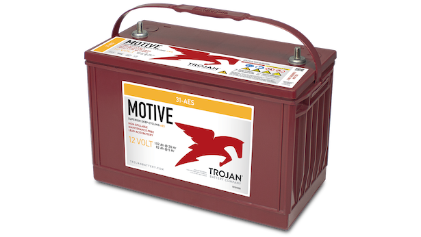

    Hi,
    Trojan batteries seem to be well respected as a quality product. I'd like to understand the Data Sheet that is found on their website regarding their different batteries.
    I'd like to use this particular battery for no other reason than we're all talking apples.
    The 31-AES 12V battery is manufactured with high-quality components, providing great energy output for better performance in different uses, such as Recreational Vehicles or Floor Cleaning Machines.
    What is this telling me?
    I undestand dimensions and won't drop this brick. But what about the first three columns
    Capacity minutes/ Capacity Amp=hours/ Energy (kWh)
    And how do these numbers correspond to the proper use of this battery. In other words using it like it should be but not beating it like a rented mule.
    Thanks, mj52
    OK first thing you need to know, is this is a SLI (Starting Lighting & Ignition) battery which is not designed for deep cycle applications. If you would have looked at the Spec sheet you will see a CCA and CA rating which means it is made to crank an engine.
    First column is RC (Reserve Capacity) Minutes and is BCI standard for the amount of time in minutes the battery can deliver 25 amps until the battery voltage drops to 1.75 volts per cell or 10.5 volts for a 12 volt battery. When you see RC Minutes means you are looking at a Hybrid Battery meaning a cross between a SLI and Deep Cycle battery.
    Capacity Amp Hours is th eAmp Hour rating of a battery at various discharge rates measured in Hours. They are usually published at the 20 hour discharge rate. This battery 20 hour Amp Hour capacity is 100 AH. That means if you discharge the battery at 5 amps, it should last 20 hours until the battery voltage drops to 1.75 volts per cell or 10.5 volts for a 12 volt battery. However if you discharge the battery at say the 5 hour rate of 20 amps, it is only a 82 Amp Hour battery. Amps = Amp Hours / Hours. Example a 100 AH battery discharged at the 20 hour rate 100 AH / 20 H = 5 amps.
    The Kwh they list is fudging numbers a bit to make it look better than what it is. To determine the watt hours a battery has is Battery Voltage x Amp Hours = Watt Hours. What they have done is used the 100 Hour Ah rating of 111 AH or 1 amp. 12 volts x 111 AH = 1332 watt hours or 1.32 Kwh. At the 5 hour rate the battery only has 12 volts x 82 AH = 984 Watt Hours or .984 Kwh.
