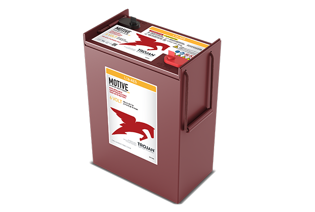

                              2 x Crown AGM 6 Volt 390 AH in series
                              https://www.wholesalesolar.com/99601...6v-l16-battery
                              2 x Trojan 6 Volt L16-AGM 370AH in series
                              The L16-AES 6V battery provides ample energy for the best performance across various applications, delivering up to 3x the cycle life of standard AGM.
                              6 x 2 Volt Lifeline AGM 630AH in series
                              http://lifelinebatteries.com/product...es/gpl-31t-2v/
