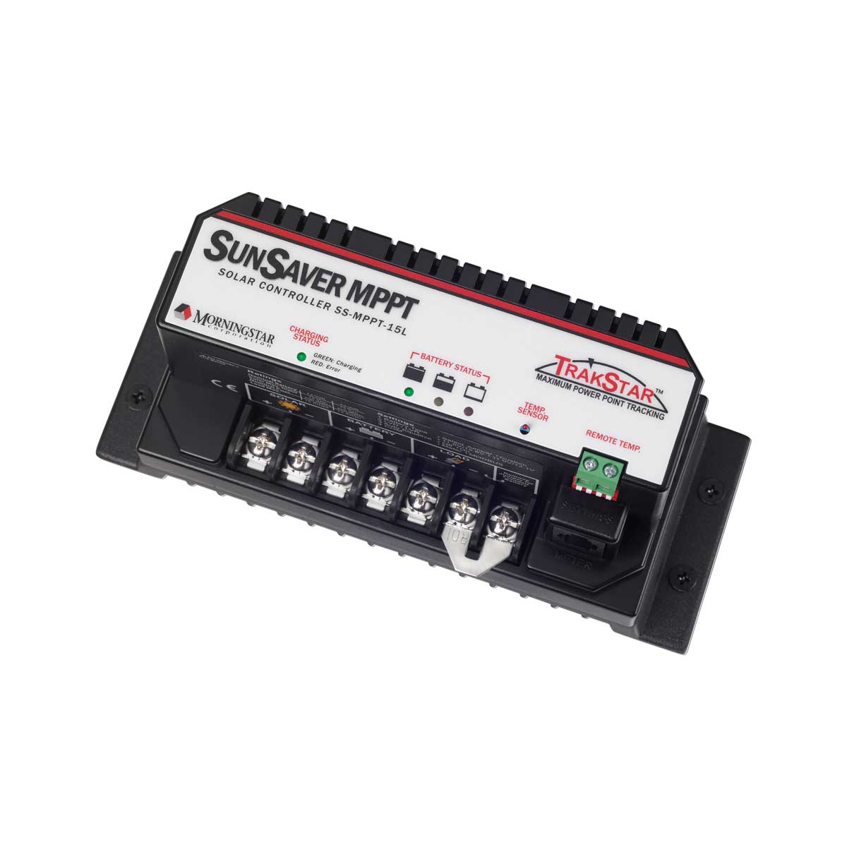

    Hey gang. I recently acquired a second 170W hand solar panel that used to be used on a house. I am hoping to be able to use it on my van to charge me auxiliary battery. I currently run a ctek d250s in the van which has a solar controller built in so I am hoping to be able to use that. Problem is the panel is 36V and the max input for the ctek is 23v. So in my research I have found a few voltage reducers on eBay that look like they will do the job of reducing the voltage from 36v to 12v but I am unsure of how many amps it needs to be?? I found one that I will attach a photo of that reduces to 12v 15A 180W but I'm not sure if 15A is way too much. Especially considering the panel is only 5amp to begin with... The ones I have found that reduce to 12v 5A only say 60W which coming from a 170 watt panel kind of defeats the purpose . I'll attach some photos below.
    thank you in advance for any help.

    Depends on what you want to do with that 12V. Those modules put out almost precisely 12V. Fine to run 12V things, but you can't charge a battery which can need almost 15V. I use a number of 180W converters like that which come in a rectangular box and only cost $5. Don't expect to get even half the amps specified.

      You need an MPPT charge controller. The DC/DC you show won't work because the panel's impedance will be too high. They are available for ~$100.
      To figure out current:
      Take your solar panel (170 watts.) That means your realistic power output is (170*80%) = 136 watts. Now divide by voltage (13.8 volts) Result - 9.8 amps.

          I'll say you cannot effectively use a 'voltage reducer' or any ordinary DC-DC converter to reduce PV array voltage to acceptable limits for battery charging.
          Just get a decent MPPT Charge Controller and let it do the work properly. Ordinary DC-DC converters cannot manage the varied current output from a PV panel, and will collapse the voltage and just shut down.

              No.
              panel puts 170W @ 36V. That works out to 4.7A
              A PWM module will give you 4.7A @ 14V which is only 66w from your panel
              A MPPT controller will give you a genuine down-conversion and you will get about 165 watts with just a few % loss.
              The morningstar 15A sunsaver MPPT
              SunSaver MPPT, Morningstar Corporation, Solar, Charge Controller, 15 Amp, Maximum Power Point Tracking
              will give you 14V at about 11.7A
                See below for longer answer.

                  You can use the CTEK in its original application. You can't use it to get much power from the panel.
                  Or are you saying I need to use another charge controller as well as the ctek??
                  Well, you could connect an MPPT controller to the battery in parallel with the CTEK. Then the CTEK wouldn't control solar charging but it would do all its usual stuff.
                  could I not just use a PWM like the one attached?
                  Sure. You will lose 60-70% of the panel's energy, but it will work (as long as the PWM controller has a high enough standoff voltage, and most PWM controllers go to at least 50 volts.) You CANNOT use a cheap DC/DC to get more power. That's what a PWM is for.
