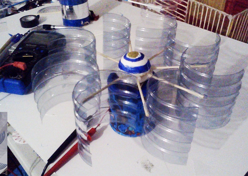

              I will keep learning and keep asking questions till I find solutions. And always doing experiments. and DIY
              I take look at some schematics. particularly solar lighting. I know I can do better product. I just need to learn ratings of each component and such. Like ohms. I dont know what this is. or uF. these things important. I just need to learn the numbers and calculations.
              I show you The wind turbine I recently made. This time it actually turns good.
              Im very happy to be learning of micro wind turbines. perhaps i can also make wind turbing also connected to solar. Hybrid model.
              This turbine gets alittle of .30v
              I plan to do bit bigger and better turbines soon. with gear ratio involved as this tiny motor does not have.
              I have schematic ideas that i will apply to make usb charger or battery charge.

                    Those wind turbines you found seem to have a very low current out in the mA range. You will need a lot of them to generate anything useful. You will also need to be in a place that has a pretty constant wind and a lot of space otherwise most small turbines just sit and do not spin fast enough to provide any output. You will also need some type of controller to pass on the output power of the wind generator to properly charge a battery. Getting any constant output would require a very constant wind input.
                    I am not trying to stop you building those things. Just trying to point out some of the basic barriers to make them be productive and economical.
