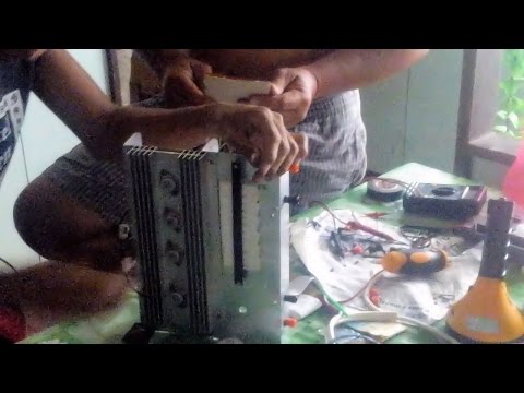

                        So I was finally able to get to the city to buy the remaining parts. I have 4 new 2N3055 transistors, 4 new 12V 1W zeners, 4 new 6.2V 1 W zeners, a heat sync and a universal PCB for a permanent (stable) construction. I've also made some final adjustments to the circuit so I can switch between 25v and 19v depending on weather conditions and what the UPS is "willing" to accept.
                        http://www.falstad.com/circuit/circu...765625+0+-1%0A
                        It will certainly take some time to fully construct this but I'm working on making some vlogs of the "experience" so when the construction is finalized, and if it works, others can use this if they're facing a similar "problem" of not being able to find a 300W 54V DC to 24V DC converter, which I can't seem to find anywhere, even on Amazon.

                          Thank you everyone for your assistance with this project. Now that the construction is complete I'm fairly happy with the end result. It may not be efficient, and may not be completely safe but it's better than nothing. Here's the video I promised of the construction ...
                          Edit: I tested this today under good weather and it successfully powered a 75W fan. Due to the way the UPS functions it cuts off every time a cloud passes over due to the low-battery cutoff circuit. Now that the circuit is down to 25V I should be able to attach a normal inverter as there are inverters available in the city that can accept the 25V. The addition of the 0.1 ohm resistors and fourth transistor also made a big difference, even at 75W load the transistors didn't get hot.
