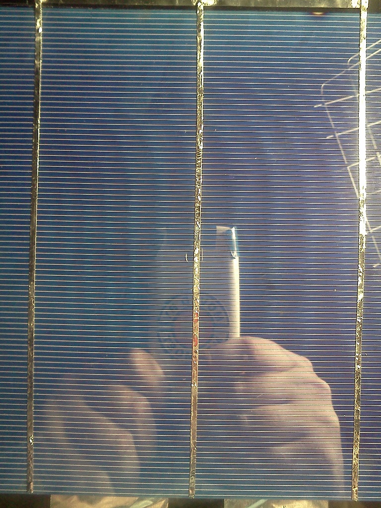

                    silver solder is likely way too hot for PV cell tabbing, and is likely to remove (dissolve) the metal film traces on the cells you are trying to solder too.
                      Don't use silver, it requires too much heat. You have been warned.

                        So Lead free Tin Silver BernzOmatic 0.62/1.6mm not good then?
                        What do you really advise?
                        Ive been using this and with very high heat... And the cells turn out okay, It welds itself pretty good. And the volt output dosnt seem to be damaged efficiency.
                        I will purchase the Kester Solder you recommend.. What temp do you guys use with this solder.
                        Everytime I solder its not very perfect... I know its the type of solder and perhaps it is the silver and the high temps not giving me clean uniform soldering..

                          Okay heres the thing. My solar cells are made of 3 busbar Silver.
                          Do you think Silver on Silver+Tin solder is safe for it you think?
                          I know you recommend Lead-Tin-silver
                          Just curious what your thoughts are.
                          And the tabbing Wire itself is Tin-Copper.
